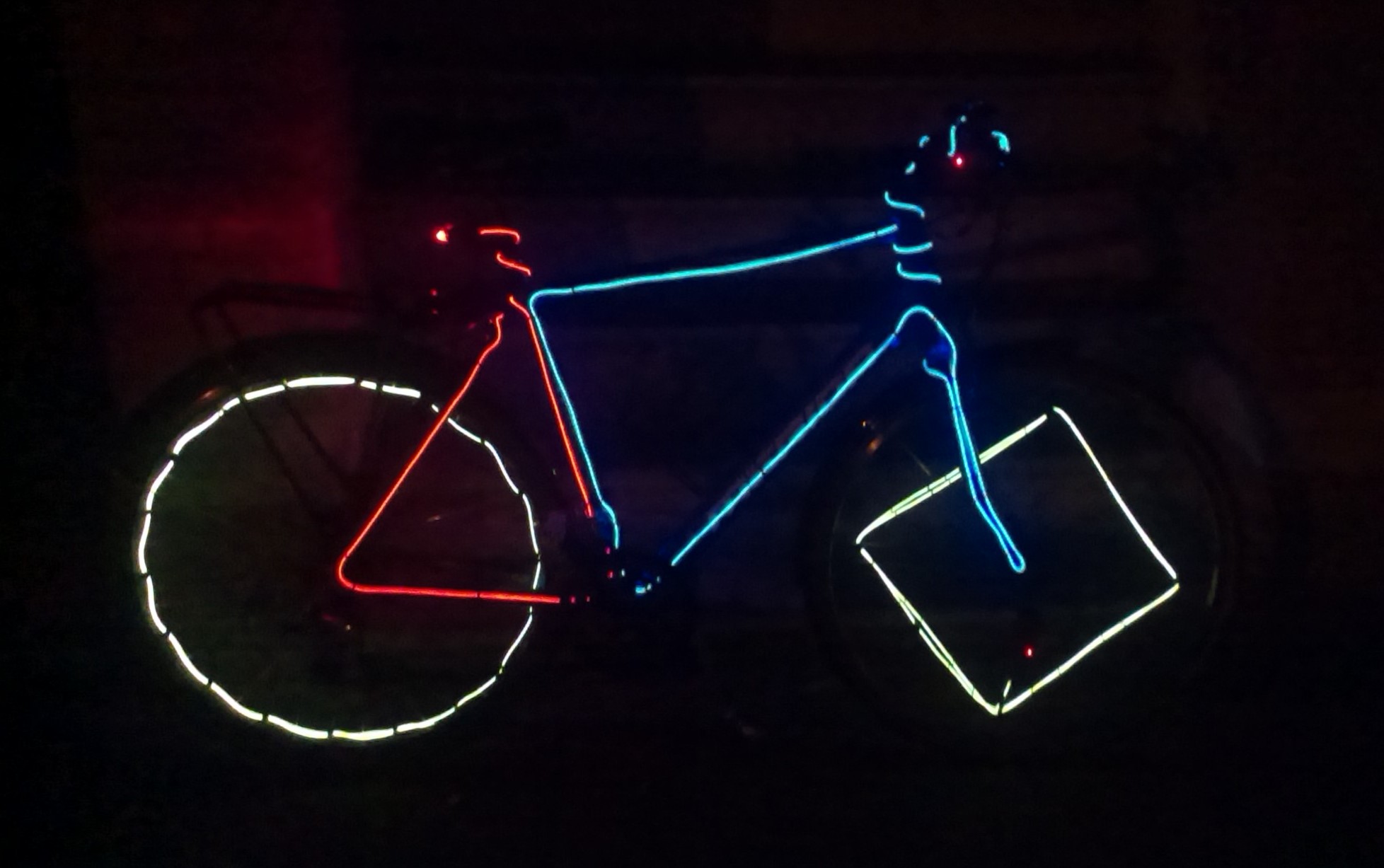

#1805 himzo
Posted 04 November 2013 - 09:46 PM
Tron bike, sezona jesen/zima :) .
