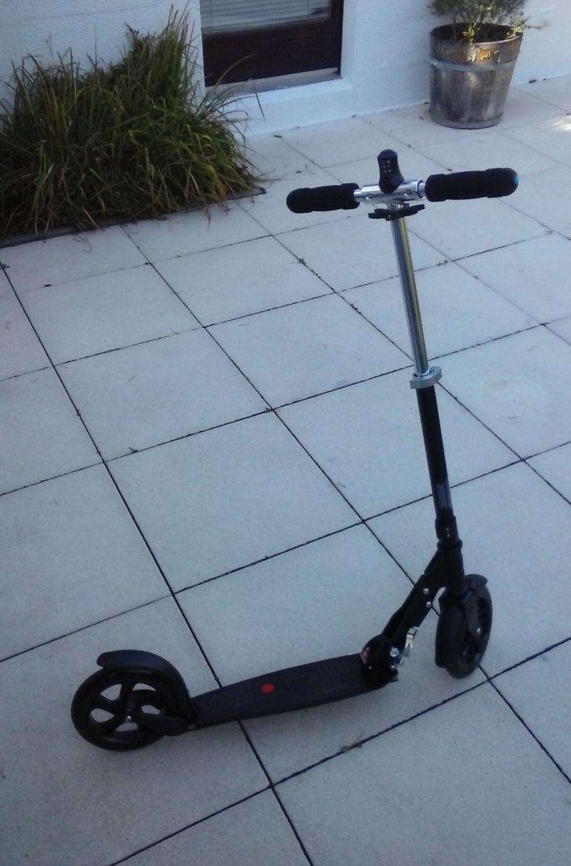

#1096 Dusan011
  • 15778 posts
Postavljeno 04 October 2016 - 03:41 PM
Najzad neko da me poslusa i uzme trotinet.
