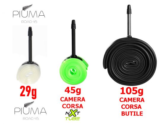

Postavljeno 15 March 2023 - 01:03 PM
https://www.bicidast...era-tpu-prezzo/
