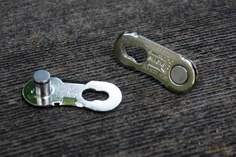

bilo nekad...a od sad..SHIMANO SPOJNICA!!! :)
https://bikerumor.co...ges-everything/
